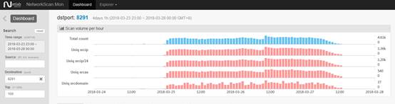

The sharp scan increase
At around 0:00 on March 25, Beijing time, our Scanmon system suggested a large number of scan activity is happening on port 8291 on a global scale.

Number of unique ips
From 2018-03-25 00:00 to 2018-03-27 12:36(GMT+8), We logged a total of 861,131 unique scan source IPs (72 Hours).(Please bear in mind that device may change ip due to device reboot etc and it does not necessary mean all these devices are MikroTik devices as all the Hajime bots will perform this task as long as they have the most recent version of Hajime code running. Also naturally there will be some noises such as researcher ips in it)
